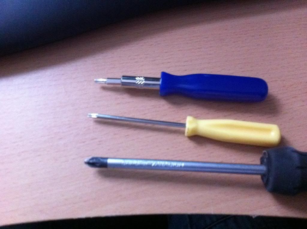

Items Needed :
Philips head screwdriver
Plyers
Torx T8
Torx T10

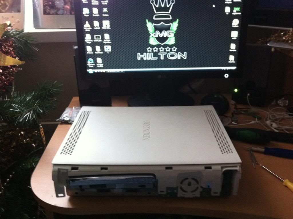

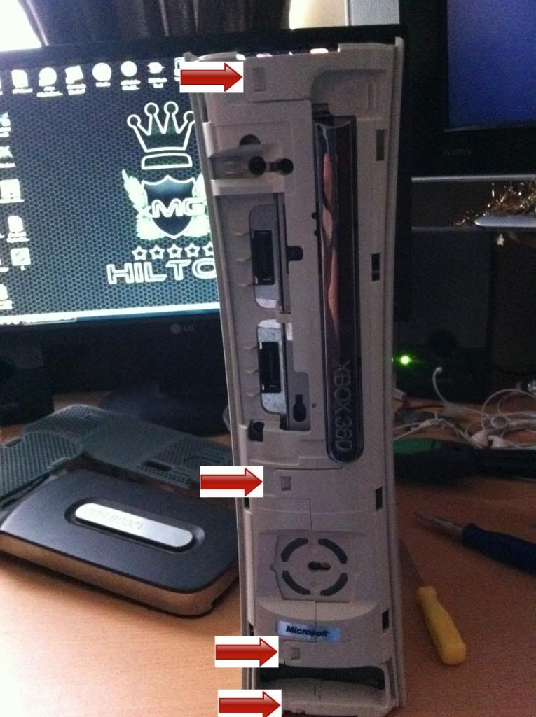

Step 1 : Remove the face plate and grey vents from top and bottom of the console.
Step 2 : Undo the clips on the front of the console.

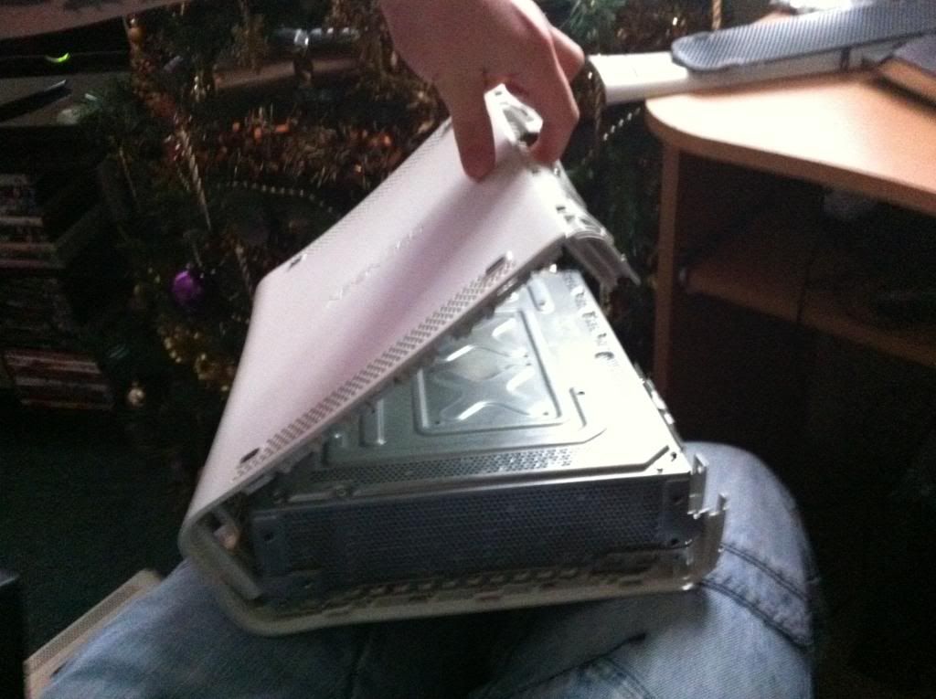

Step 3 : Bend back the outer plastic case (it will feel like its going to snap but if you take your time with it, it wont)

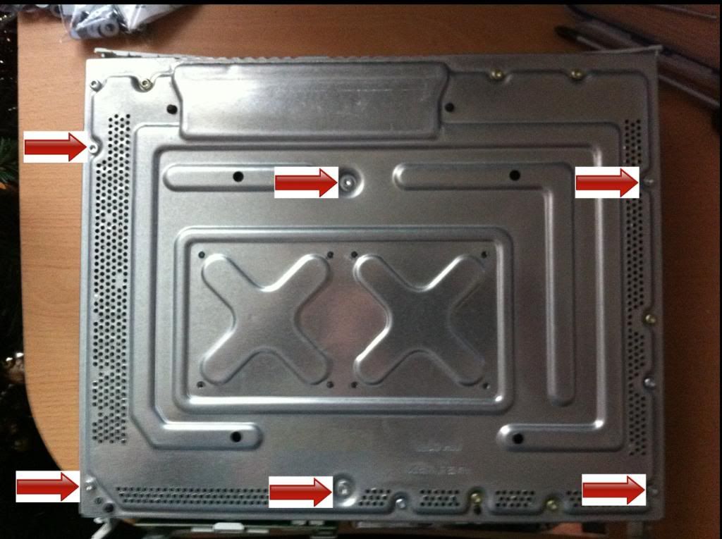

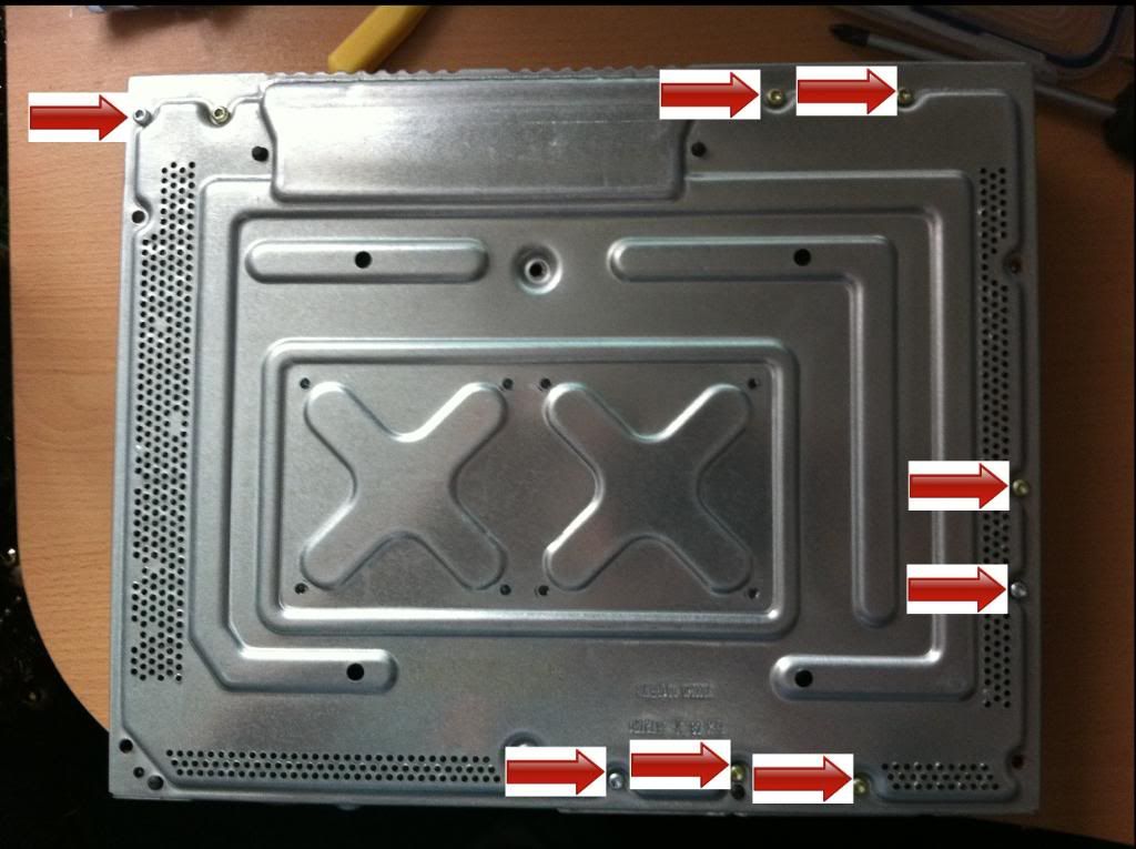

Step 4 : Undo the Large and small screws and place to one side
Step 5 : Lift off the outer case and place to one side.

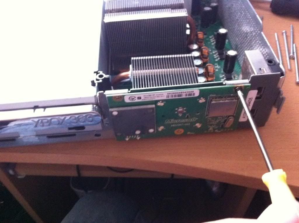

Step 6 : Undo the screws from your RF Board and remove.

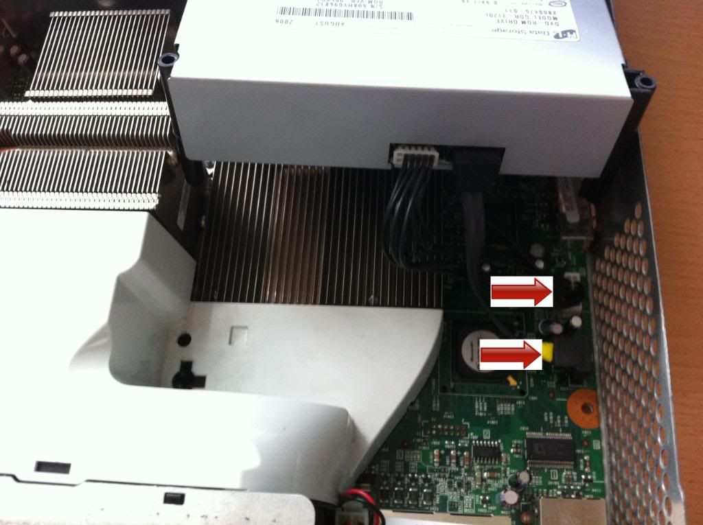

Step 7 : Lift up your DVD Drive and disconect the cables to the rear and place the drive to one side.

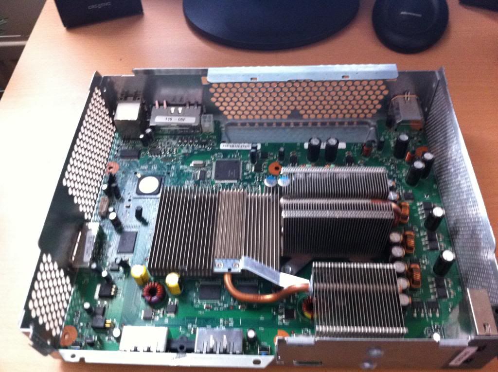

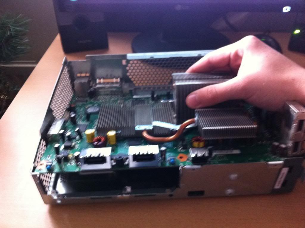

Step 9 : Holding the heatsync pull the motherboard out of the metal chassis.

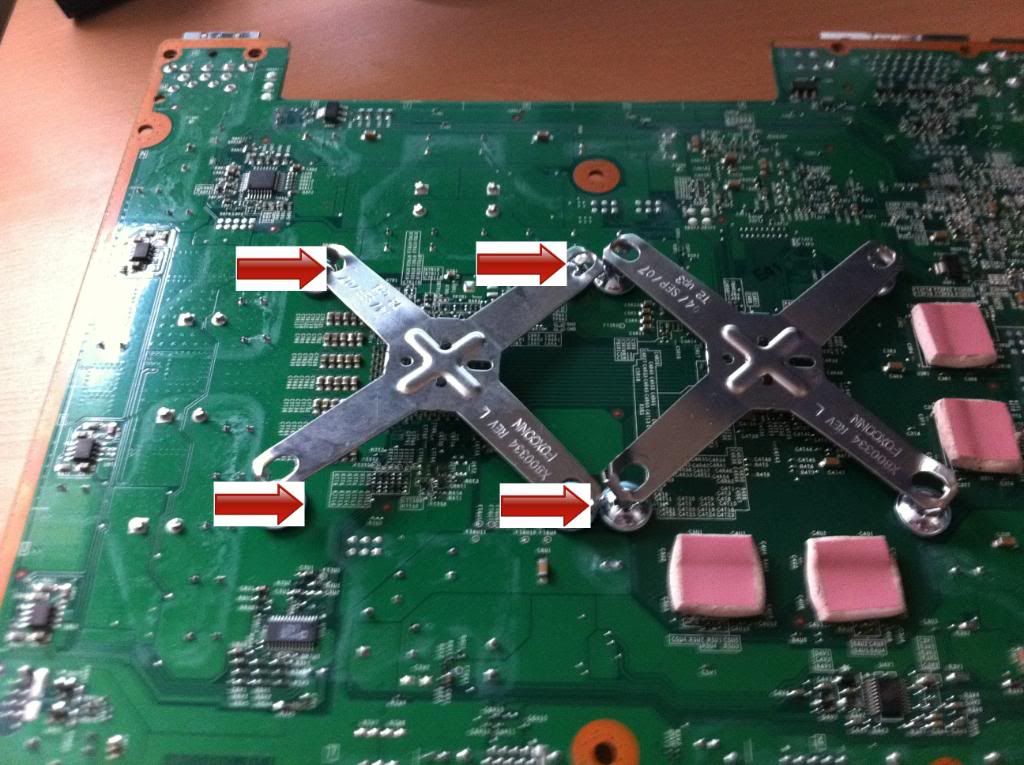

Step 10 : Now to remove the heatsyncs and Xclamps. Turn over your motherboard so it is upside down. Now you will have 2 Xclamps there. You will need to place a screw driver (small one) into the end of each leg of the Xclamp where the bolt is and riggle it free.
Once free you will be able to take off the Heat syncs.
You will be left with the bolts in the heatsyncs, just take a set of pliers and unscrew them.

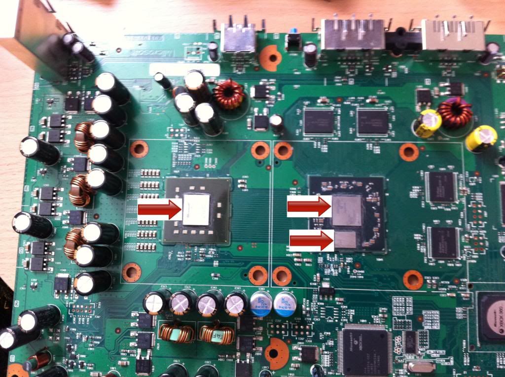

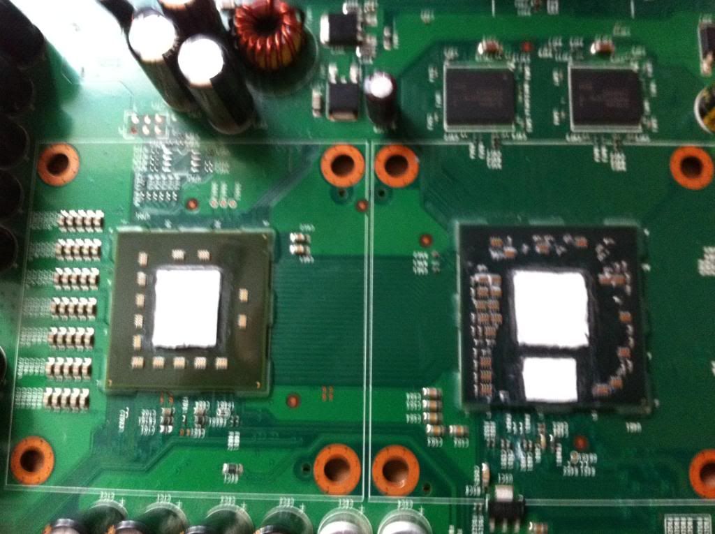

Step 11 : You will notice on the GPU and CPU there is a grey gunk all over the chips, you will need to get some Methylated Spirit and some cotton budds (of for the USA folk "cue tips") and rub the chips untill they are like new and free from any old heat paste.

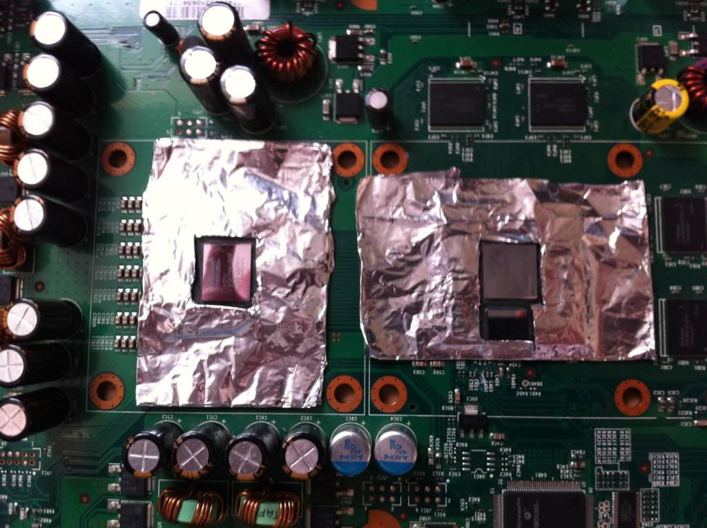

Step 12 : Take some kitchen foil and place around the chips to act as a heat shield for the other components around the chip.
Step 13 : Now you will need HEAT! I personaly use a Heat Gun but a hair dryer will suffice, now hold it around 2 inches above the chip and heat for around 3 mins each.

Step 15 : You will now need to place a small amount of heat paste onto the GPU/CPU. Use just enough to put a layer over the whole chip ( ONLY THE SHINEY BIT!!!)

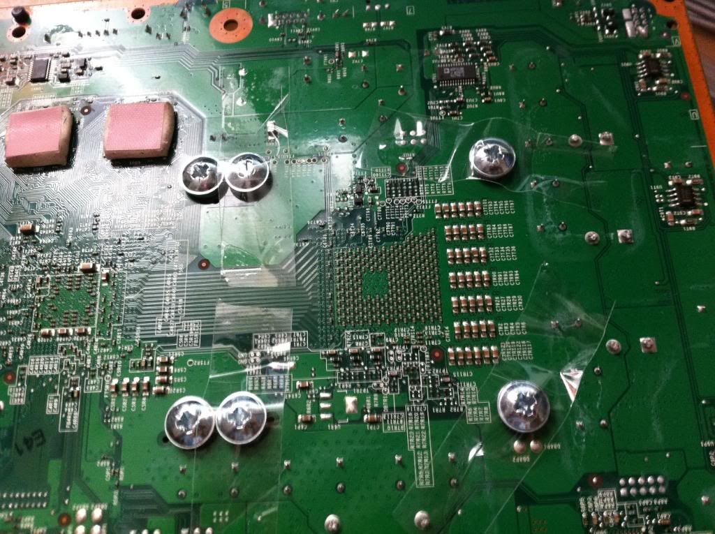

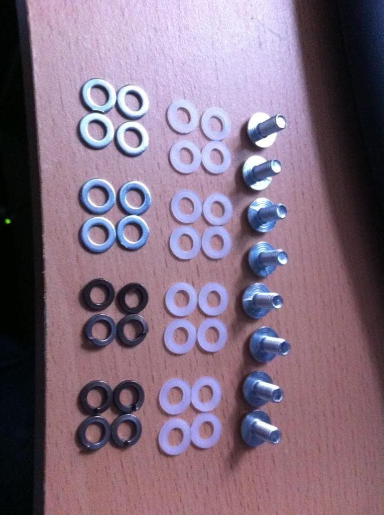

Step 16 : Now get your screws and washers, Place a metal washer and a nylon washer on the screw (metal first then nylon so the nylon will be against the board) turn you board upside down and place in the holes. Hold them in place with sellotape for ease, then turn the board over and place a nylon then metal washer to the other side where the screw is protruding through.
Step 17 : Now take you first heat sync and place it onto the screws and while still holding the heat sync hold your board upright and screw the syncs to the board. (repeat for other heat sync)
